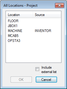

  6. Select installation or location codes to extract.
    • All. Extracts all components regardless of value.
    • Blank. Extracts only those components that do not have a value.
    • Named. Extracts only those components that have a value matching the value entered in the box. Wild-card characters are supported.
      The Drawing button is disabled but you can select a value from the Project list. The project lists for Installation and Location include values from the Inventor assembly. Values from Inventor are indicated in the Source column.

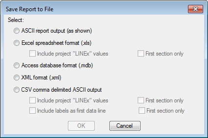

Save the Report to a File
  1. Generate a report.
  2. In the Report Generator dialog box, select Save to File.
  3. Select the file format.
  4. Choose any options within the selected file type.
    • LINEx values. Project description lines marked as in reports.
    • Labels. Labels for the fields included in the report.
    • First section only. If the report contains special breaks, select whether to include on the first section only.
  5. Click OK.
  6. Enter a file name and define the path and click Save.
  7. The Optional Script File dialog box displays where you can run an optional script on your report data.
  8. Click Close on the Report Generator dialog box.

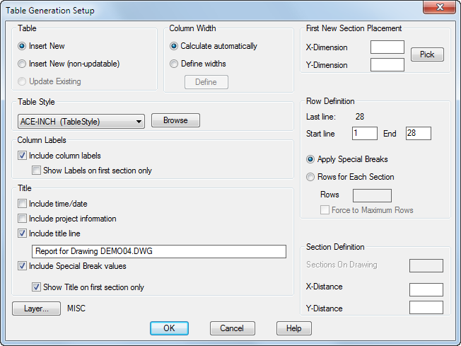

Insert a Report as a Table
  2. In the Report Generator dialog box, select Put on Drawing.
  3. Select the table type:
    • Insert New. If the same report is run again later, the table can be updated.
    • Insert New (non-updatable). If the same report is run again later, the table is not updated.
    • Update Existing. If there is an existing table that matches the report, it updates. This option is not available if there are no matching tables for the report.
  4. Select a table style from the list. You can browse to another drawing and add any tables style on that drawing to the selection list.
  5. Specify whether to include any title information.
  6. Specify the method to use for calculating the width of the columns.
  7. Specify the XY coordinates for the upper left corner of the table. If left blank, you are prompted to select a location after you click OK.
  8. Enter a start and end line value. The default is to include all rows of report data.
  9. Specify the options for the rows:
    • Apply Special Breaks. If you selected any special breaks on the Report Generator box, you can break the table into separate table objects based on those values.
    • Rows for Each Section. Specifies to break the report into separate table objects based on the value in the Rows box.
  10. If table sections are defined:
    • Specify the maximum number of table sections placed on each drawing. A blank value indicates an unlimited number of sections on one drawing.
    • Specify the X and Y distance from the end of one table section to the beginning of the next. These values are used when there are multiple sections on the same drawing.
  11. Click OK.
    If you did not specify the XY coordinates, your cursor is a box approximating the size of the table when it is generated. To use object snap mode, enter an S at the command line.

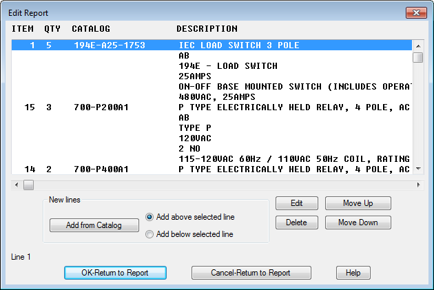

Edit a Report
Modify the report before you insert it to your drawing or save it to a file. You can move data up or down in the report, add lines from a catalog, and delete lines.
  2. In the Report Generator dialog box, select Edit Mode.
  3. Select a row within the report.
  4. Click Edit to change individual values in that row.
  5. Select a row or group of rows within the report.
    • Click Delete to remove the selected rows.
    • Use the available move options to change the order of the selected rows.

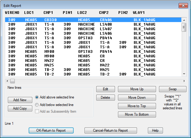

  6. Use the available options to add extra rows with data to the report. Options differ depending on the report type.
  7. If the report contains wiring information, each line item in the report can include two connected components, referred to as the From and To components. The From field labels end in a 1 and the To field labels end in a 2.
    Click Swap to swap the From and To field values.
  8. Click OK-Return to Report.
