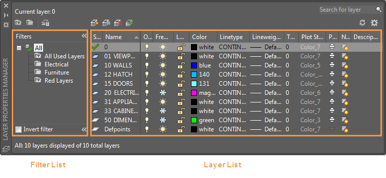

Creates a layer with a default name that you can immediately change. The new layer inherits the properties of the currently selected layer in the layer list.
Creates a layer and freezes it in all existing layout viewports. This button is accessible from the Model tab or layout tabs.
Deletes selected layers. The following layers cannot be deleted:
Sets the selected layer as the current layer. New objects are automatically created on the current layer. (CLAYER system variable)
Modify the layer properties using the layer list. Click the current setting to change the layer property for the selected layer or group of layers.
This layer is the current layer
This layer contains objects
This layer does not contain any objects
, by default. You can turn on this feature in layer settings.
This layer contains objects, and a property override is turned on in a layout viewport
This layer does not contain any objects, and a property override is turned on in a layout viewport Displays the name of the layer or filter. Press F2 to enter a new name.

Displays the Layer Filter Properties dialog box, where you can create a layer filter. Layer filters limit the layers listed in the Layer Properties Manager to those with specified settings and properties. For example, you can limit the list of layers to only those that are turned on and thawed.
Creates a layer filter that includes only the layers that you drag to the filter.
Displays all layers that do not meet the criteria in the selected layer filter.
Displays the list of layer filters in the drawing. Click

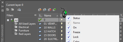

Lists all columns by name. A check mark indicates that the column is included in the display. Click a column name to display or hide the column. VP Freeze, VP Color, VP Linetype, VP Lineweight, and VP Plot Style are available only when a layout viewport is active.
Displays the Customize Layer Columns dialog box, where you can specify which columns are hidden or displayed, or change the column order.

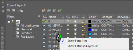

Displays the Filters list. Clear this option to hide the list. Same as
Displays layer filters at the top of the layer list. Clear this option to display only layers in the layer list.

Displays a list of layer filters, including default layer filters. Click a filter to apply it to the layer list.
