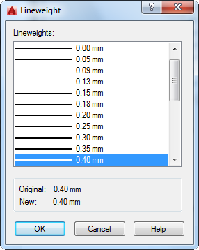

Displays the lineweight values available.
Assigns a lineweight to a layer. You can customize lineweights to plot with other values by using the Plot Style Table Editor.
The following options are displayed.
Displays the available lineweights to be applied. Available lineweights consist of fixed values that are most commonly used in drawings. Select a lineweight to apply it.
Displays the previous lineweight. The default lineweight assigned when a layer is created is DEFAULT (which plots to a default value of 0.01 inches or 0.25 mm). (LWDEFAULT system variable)
Displays the new lineweight assigned to the layer.
