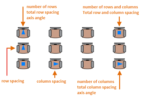

With associative arrays, you can perform edits directly using grips, with grip menu options that appear when you hover over a grip, or by using the ARRAYEDIT command from the contextual tab or at the Command prompt. For example, here are the primary controls for a rectangular array of chairs. Path arrays and polar arrays have similar controls.
