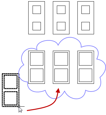

Replace Items
Replace selected items with other objects. Any item overrides are maintained. You can also replace all items that reference the original source objects or select individual items to be replaced.
In this example, three of the six items in the array (shown above) are replaced by items with larger panes.

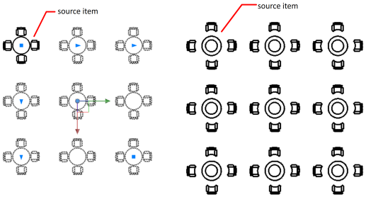

Edit Source Objects
To edit an item’s source objects, activate an editing state for a selected item. All changes (including the creation of new objects) are instantly applied to all items that reference the same source objects. Save or discard your changes to exit the editing state.
