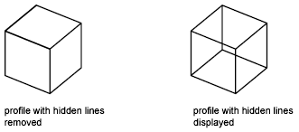

Display hidden profile lines on separate layer? [Yes/No] <Y>: Enter y or n, or press Enter
Yes
Generates only two blocks: one for the visible lines and one for the hidden lines of the entire selection set. When you generate hidden lines, solids can partially or completely hide other solids. The visible profile block is drawn in the BYLAYER linetype, and the hidden profile block is drawn in the HIDDEN linetype (if loaded). The visible and hidden profile blocks are placed on uniquely named layers using the following naming conventions:
PV-viewport handle for the visible profile layer
PH-viewport handle for the hidden profile layer
For example, if you create a profile in a viewport whose handle is 4B, the blocks containing the visible lines are inserted on layer PV-4B, and the block containing the hidden lines (if requested) is inserted on layer PH-4B. If these layers do not exist, the command creates them. If the layers do exist, the blocks are added to the information already on the layers.
Note: To determine the handle of a viewport, select the viewport while in paper space and use the LIST command. Choose a layout tab to move from model space to paper space.
SOLPROF does not change the display of layers; if you want to view only the profile lines that you have created, turn off the layer containing the original solid (usually the current layer).
No
Treats all profile lines as visible lines and creates a block for the profile lines of each selected solid. All profile lines for each solid in the selection set are generated, even if a solid is partially or completely obscured by another solid. The visible profile blocks are drawn in the same linetype as the original solid and placed on a uniquely named layer using the naming convention described under the Yes option.

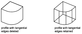

Creates the profile lines with 3D objects.
The next prompt determines whether tangential edges are displayed. A tangential edge is the transition line between two tangent faces. It's the imaginary edge at which two faces meet and are tangent. For example, if you fillet the edge of a box, tangential edges are created where the cylindrical face of the fillet blends into the planar faces of the box. Tangential edges are not shown for most drafting applications.
