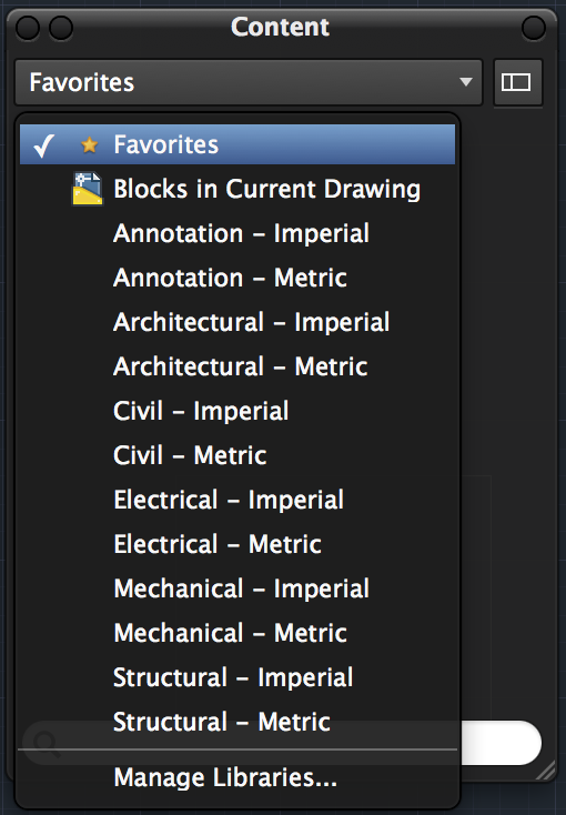

Allows you to access and insert your blocks stored in libraries.
The following options are displayed.
Displays the available libraries. Select a library to insert blocks from or select Manage Libraries to display the Manage Content Libraries dialog box. The following libraries are available by default:
Displays the Manage Content Libraries dialog box in which you create and manage content of libraries.
Displays the blocks in the library selected from the Libraries list.
