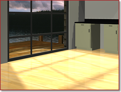

Shadow maps provide softer edges and require less calculation time than ray-traced shadows, but are less accurate. Shadow maps are the only way to generate soft-edged shadows, but they do not show the color cast by transparent or translucent objects.
The following example shows how shadow maps produce softer, less precise shadows.
During a pre-rendering pass, a shadow map bitmap is created. Shadow quality can be controlled by increasing or decreasing the size of the shadow map. The default shadow map size is 256 x 256 pixels. If the shadow appears to be too grainy, increasing the map size improves quality. Shadow mapped shadows should not be used if you have a light shining through a transparent surface (for example, a multi-pane window where you want the frame and mullions to cast shadows). You’d have to remove the glass in order for the mullions to cast shadows.

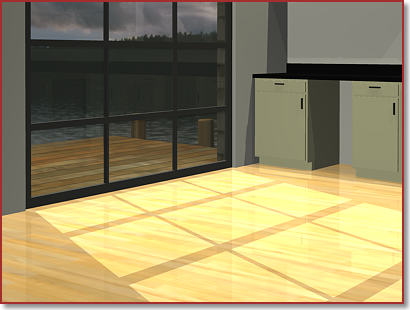

Ray tracing traces the path of rays sampled from the light source. Shadows appear where rays have been blocked by objects. Ray-traced shadows have more accurate, hard edges and require more calculation time.
The following example shows that while ray tracing takes longer to process, it produces more realistic, precise shadows.
Ray-traced shadows have hard edges and accurate outlines; they also transmit color from transparent and translucent objects. Therefore, shadows of the frame and mullions of a multi-pane window will render. Because ray-traced shadows are calculated without a map, you don't have to adjust resolution as you do for shadow-mapped shadows.
