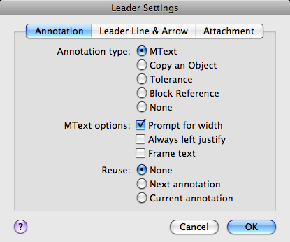

Sets the leader annotation type. The type you select changes the QLEADER leader annotation prompt.
Prompts you to create multiline text (mtext) annotation.
Prompts you to copy a multiline text, single-line text, tolerance, or block reference object and connects the copy to the end of the leader line. The copy is associated with the leader line, meaning that if the copied object moves, the end of the leader line moves with it. The display of the hook line depends on the object copied.
Displays the Tolerance dialog box, which you can use to create a feature control frame to attach to the leader.
Prompts you to insert a block reference. The block reference is inserted at an offset from the end of the leader line and is associated to the leader line, meaning that if the block moves, the end of the leader line moves with it. No hook line is displayed.
Creates a leader with no annotation.
The options are available only when the multiline text annotation type is selected.
Prompts you to specify the width of the multiline text annotation.
Left-justifies the multiline text annotation, regardless of leader location.
Places a frame around multiline text annotation.
Sets options for reusing leader annotation.
Does not reuse leader annotation.
Reuses the next annotation you create for all subsequent leaders.
Reuses current annotation. This option is automatically selected when you reuse annotation after selecting Reuse Next.

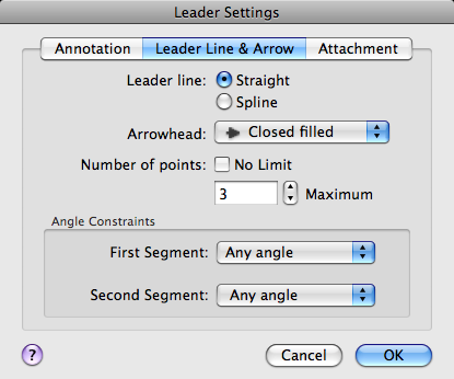

Sets the leader line format.
Creates straight-line segments between the points you specify.
Creates a spline object using the leader points you specify as control points.
Defines the leader arrowhead. The arrowheads are also available for dimension lines (DIMSTYLE command). If you select User Arrow, a list of blocks in the drawing is displayed.
Sets the number of leader points that QLEADER prompts you to specify before prompting for the leader annotation. For example, if you set the points to 3, QLEADER automatically prompts you to specify the annotation after you specify two leader points. Set the number to one more than the number of leader segments you want to create.
If you set the option to No Limit, QLEADER prompts for leader points until you press Enter.
Sets angle constraints for the first and second leader lines.
Sets the angle of the first leader segment.
Sets the angle of the second leader segment.

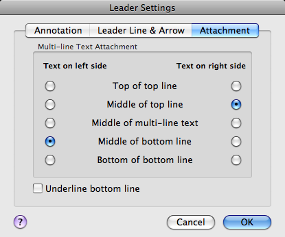

Sets the attachment location for leader lines and multiline text annotation. This tab is available only when Mtext is selected on the Annotation tab.
Attaches the leader line at the top of the top multiline text line.
Attaches the leader line at the middle of the top multiline text line.
Attaches the leader line at the middle of the multiline text.
Attaches the leader line at the middle of the bottom multiline text line.
Attaches the leader line at the bottom of the bottom multiline text line.
Underlines the bottom multiline text line.
