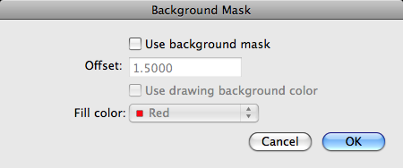

Controls using an opaque background behind multiline text.
The following options are displayed.
Puts an opaque background behind the text.
Specifies the margin around the text for the opaque background. The value is based on the text height. A factor of 1.0 exactly fits the multiline text object. A factor of 1.5 extends the background by 0.5 times the text height.
Provides a background that is the same color as the background of the drawing.
Specifies the color for the background.
Specifies a color for the opaque background. You can select one of the colors in the list or click Select Color to open the Color Palette dialog box.
