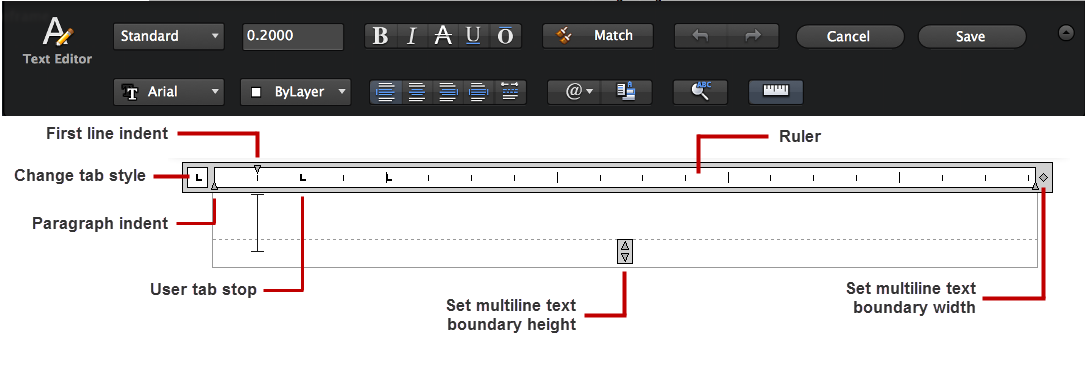

The In-Place Text Editor includes
When a table cell is selected for editing, the In-Place Text Editor displays column letters and row numbers.
The following options are displayed.

Controls the display of the ruler.
