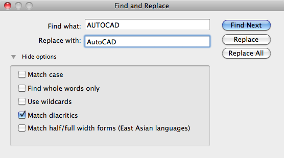

Searches for specified text strings and replaces them with new text.
The following options are displayed.
Provides a space for you to type the text you want to find.
Provides a space for you to type the text you want to replace the text you typed in Find What.
Finds the next instance of the text specified in Find What.
Finds the next instance of the text specified in Find What and replaces it with the text in Replace With.
Finds all instances of the text specified in Find What and replaces it with the text in Replace With.
Specifies advanced find options.
Finds only text with uppercase and lowercase characters as specified in Find What.
The case of all characters in the text string must match the case of the text in Find What. When this option is cleared, a match is found for specified text strings regardless of case.
Finds only whole words specified in Find What.
Text that is part of another word is ignored. When this option is cleared, a match is found for text strings, whether they are single words or parts of other words.
Allows the use of wildcard characters in searches.
For more information on wildcard searches, see Find and Replace Text.
Matches diacritical marks, or accents, in search results.
Matches half- and full-width characters in search results.
