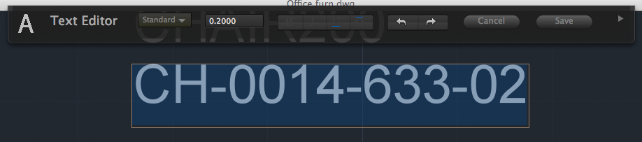

Changes the textual content of an attribute within a block.
If you select a single-line attribute, displays the In-Place Text Editor without the ruler. Right-click to display options. Selecting a multiple-line attribute displays the In-Place Text Editor with the ruler.
Depending on the setting of the ATTIPE system variable, the right-click menu changes the formatting and editing operations available for compatibility with previous AutoCAD for Mac releases.
The following prompts are displayed.
Select attribute to edit: Select an attribute within a block
