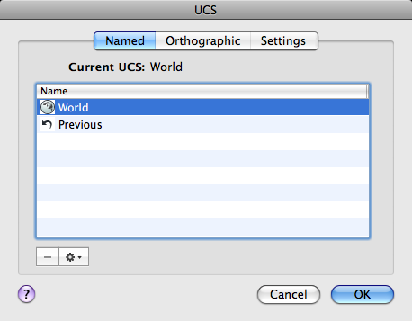

Lists, renames, and restores user coordinate system (UCS) definitions, and controls UCS and UCS icon settings for viewports.
Lists UCS definitions and sets the current UCS.
Displays the name of the current UCS. If the UCS has not been saved and named, it is listed as UNNAMED.
Lists the coordinate systems defined in the current drawing. If there are multiple viewports and multiple unnamed UCS settings, the list includes only the unnamed UCS of the current viewport. Unnamed UCS definitions that are locked to other viewports (UCSVP system variable = 1) are not listed in the current viewport. A pointer indicates the current UCS.
UNNAMED is always the first entry if the current UCS is unnamed. World is always listed and cannot be renamed or deleted. If you define other coordinate systems for the active viewport during the current editing session, a Previous entry is next. You can step back through these coordinate systems by selecting Previous and Set Current repeatedly.
To add a UCS name to this list, use the Save option of the UCS command.
Deletes a named UCS. You cannot delete the World or Previous UCS.
Manages the selected UCS in the dialog box.
Restores the selected coordinate system.
Renames a customized UCS. You cannot rename the World UCS.
Displays the UCS Details dialog box, which displays UCS coordinate data.

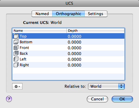

Changes the UCS to one of the orthographic UCS settings.
Lists the six orthographic coordinate systems defined in the current drawing. The orthographic coordinate systems are defined relative to the UCS specified in the Relative To list.
Specifies the base coordinate system for defining the orthographic UCSs. By default, WCS is the base coordinate system.
Whenever you change the Relative To setting, the origin of the selected orthographic UCS is restored to its default position.
If you save an orthographic coordinate system in a drawing as part of a viewport configuration, or if you select a setting in Relative To other than World, the orthographic coordinate system name changes to UNNAMED to distinguish it from the predefined orthographic coordinate system.
Restores the origin of the selected orthographic coordinate system. The origin is restored to its default location (0,0,0) relative to the specified base coordinate system.
Specifies the distance between the XY plane of the orthographic UCS and a parallel plane that passes through the origin of the coordinate system. In the Orthographic UCS Depth dialog box, enter a value or choose the Select New Origin button to use the pointing device to specify a new depth or a new origin.

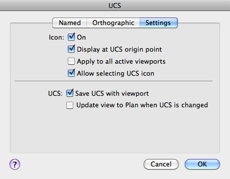

Displays and modifies UCS icon settings and UCS settings saved with a viewport.
Specifies the UCS icon display settings for the current viewport.
Displays the UCS icon in the current viewport.
Displays the UCS icon at the origin of the current coordinate system in the current viewport. If this option is cleared, or if the origin of the coordinate system is not visible in the viewport, the UCS icon is displayed at the lower-left corner of the viewport.
Applies the UCS icon settings to all active viewports in the current drawing.
Controls whether the UCS icon is highlighted when the cursor moves over it and whether you can click to select it and access the UCS icon grips.
Specifies UCS behavior when the UCS setting is updated.
Saves the coordinate system setting with the viewport (UCSVP system variable). If this option is cleared, the viewport reflects the UCS of the viewport that is current.
Restores Plan view when the coordinate system in the viewport is changed. (UCSFOLLOW system variable)
