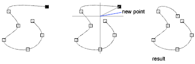

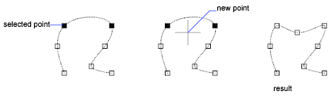

Adds fit points to the spline.
After selecting a fit point, specify a new fit point to be added to the spline in the direction of the next fit point, which is automatically highlighted.
If you select the last fit point on an open spline, the new fit point is added to the end of the spline.
If you select the first fit point on an open spline, you have the option of specifying whether the new fit point is added before or after the first point.
