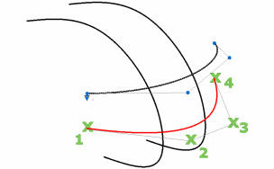

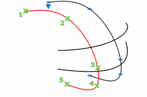

For splines created with the fit point method:
Specify first point or [Method/Degree/Object]:
For splines created with the control vertices method:
Specify first point or [Method/Knots/Object]:
Specifies the first point of the spline, either the first fit point or the first control vertex, depending on the current method.
Controls whether the spline is created with fit points or with control vertices. (SPLMETHOD system variable)
Creates a degree 3 (cubic) B-spline by specifying fit points that the spline must pass through. When the tolerance value is greater than 0, the spline must be within the specified tolerance distance from each point.
Changing the Method updates the SPLMETHOD system variable.
Creates a spline by specifying control vertices. Use this method to create splines of degree 1 (linear), degree 2 (quadratic), degree 3 (cubic), and so on up to degree 10. Adjusting the shape of a spline by moving control vertices often provides better results than moving fit points.
This is the preferred method if you are creating geometry to use with 3D NURBS surfaces.
