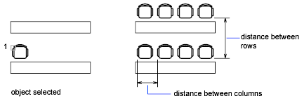

Creates an array of rows and columns of copies of the selected objects.
Enter the number of rows (---) <1>: Enter a nonzero integer or press Enter
Enter the number of columns (|||) <1>: Enter a nonzero integer or press Enter
If you specify one row, you must specify more than one column and vice versa.
The selected object, or cornerstone element, is assumed to be in the lower-left corner, and generates the array up and to the right.
The specified distance between the rows and columns includes the corresponding lengths of the object to be arrayed.
Enter the distance between rows or specify unit cell (---):
To add rows downward, specify a negative value for the distance between rows. ARRAY skips the next prompt if you specify two points for the opposite corners of a rectangle.
Specify the distance between columns (|||):
To add columns to the left, specify a negative value for the distance between columns. Rectangular arrays are constructed along a baseline defined by the current snap rotation. This angle is normally 0, so the rows and columns are orthogonal with respect to the X and Y drawing axes. The Rotate option of the SNAP command changes the angle and creates a rotated array. The SNAPANG system variable stores the snap rotation angle.
