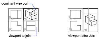

Combines two adjacent model viewports into one larger viewport.
The two model viewports must share a common edge of the same length. The resulting viewport inherits the view of the dominant viewport.

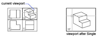

Returns the drawing to a single viewport view, using the view from the current viewport.
