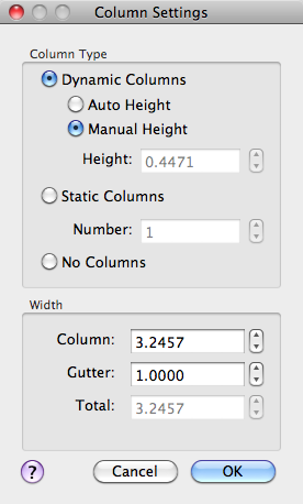

Displays options for setting up columns such as the type, number of columns, height, and width, and gutter size.
The following options are displayed.
Lists choices for the type of columns you want to create.
Displays the height of the multiline text object when Auto Height with Dynamic or Static Columns is selected.
Sets the number of columns. This is only active when you select Static Columns.
Displays and specifies control column and gutter width values. The gutter value is five times the default multiline text height.
Also displays the total width value of the multiline text object.
