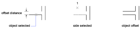

You can offset an object at a specified distance or through a point. After you offset objects, you can trim and extend them as an efficient method to create drawings containing many parallel lines and curves.

Specify Offset Distance or [Through/Erase/Layer] <current>: Specify a distance, enter an option, or press Enter
Creates an object at a specified distance from an existing object.
