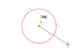

Specify center point for circle or [3P/2P/Ttr (tan tan radius)]: Specify a point or enter an option
Draws a circle based on a center point and a diameter or a radius.
Defines the radius of the circle. Enter a value, or specify a point.
For example:
Defines the diameter of the circle. Enter a value, or specify a second point.
For example:

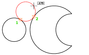

Draws a circle with a specified radius tangent to two objects.
Sometimes more than one circle matches the specified criteria. The program draws the circle of the specified radius whose tangent points are closest to the selected points.
For example:
