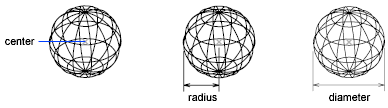

Specify center point or [3P/2P/Ttr]: Specify a point or enter an option
Center Point
Specifies the center point of the sphere.
When you specify the center point, the sphere is positioned so that its central axis is parallel to the Z axis of the current user coordinate system (UCS). Latitudinal lines are parallel to the XY plane.
Radius
Defines the radius of the sphere.
Diameter
Defines the diameter of the sphere.
