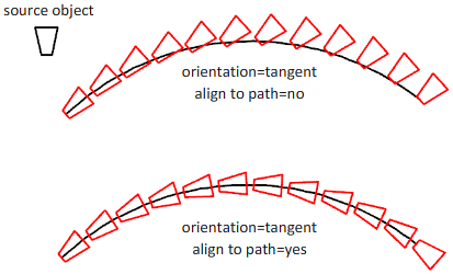

Specifies how the arrayed items are aligned relative to the path.
Specifies two points that represent the tangency of the arrayed items relative to the path. The vector of the two points establishes the tangency of the first item in the array. The Align Items setting controls whether the other items in the array maintain a tangent or parallel orientation.

Specifies whether to align each item to be tangent to the path direction. Alignment is relative to the first item’s orientation.
