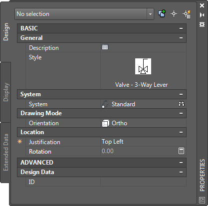

  2. On the Properties palette, if necessary, specify or change the symbol to add by selecting a schematic symbol style:
    If you want to select a schematic symbol style… then…
    in the current drawing expand Basic, and expand General. For Style, select the style.
    in a drawing in the directory specified as the default content location for schematic symbols, or in the style drawing referenced in the properties of a tool you selected on the General bar, click . In the left pane of the Select Schematic Symbol worksheet, navigate to the drawing that contains the style, and select the drawing. In the right pane, select the style, and click OK.
  3. For Description, click , enter a description for the schematic symbol, and click OK.
  4. For System, select the system to which the schematic symbol belongs.
    You can select from the systems in the current drawing.
  5. If Orientation is enabled under Drawing Mode, select Ortho.
    Note: If the style you selected does not have any defined isometric views, Orientation is read-only and set to Ortho.
  6. For Justification, select the point on the symbol to use as the insertion point.
    You can select either the insertion point of the view block that represents the symbol, or one of 9 other points on the device, such as Top Left or Middle Center.
  7. Expand Advanced, and for ID, enter the ID to use to identify this symbol.
    You can add the ID to your diagram as a label. The label style that you select when you add the label determines the font and size of the ID.
