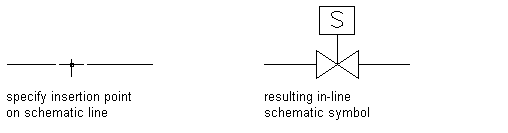

- In-line symbols. These symbols can be anchored anywhere along a schematic line. Fittings, valves, gauges, and controls such as switches, signals, and devices are examples of in-line symbols. These symbols are attached to the line. They move when the line is moved, and they are erased when the line is erased. You can also relocate the symbol by moving the symbol along the schematic line.
Inserting a schematic symbol into a schematic line
