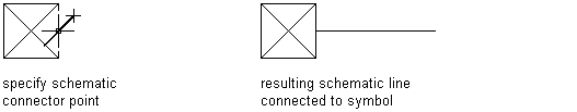

Connecting a schematic line to a schematic symbol

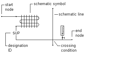

Mechanical schematic line and symbol components

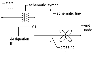

Electrical schematic line and symbol components

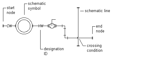

Plumbing schematic line and symbol components
