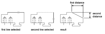

Click an empty space in the drawing area.
Select the first line that forms the corner.
Select the second line that forms the corner.
Press ESC to exit the command.
