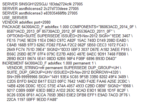

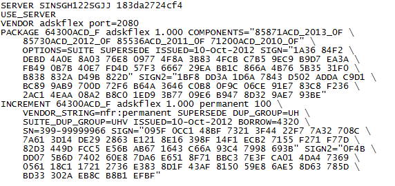

Example of a completed package license file for a single or distributed license server model:
Example of a completed package license file for a redundant license server model:
The distinguishing feature of this type of license file is the series of three SERVER lines at the beginning. A copy of this license file is placed on each of the specified servers.

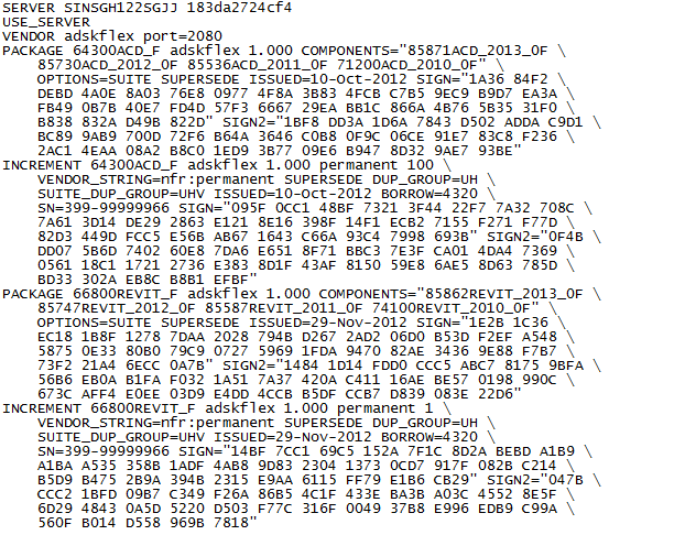

Example of a combined package license file for AutoCAD 2010 to 2013 and Revit 2010 to 2013:
