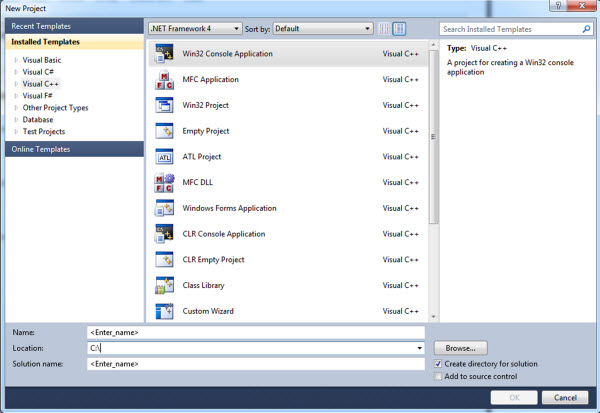

To create a new Visual Studio solution that uses FBX SDK:
  1. Start Visual Studio.
  2. To create a new project, choose New Project the File menu.
  3. Choose Visual C++ Win32.
  4. Continue as usual, then click Finish. The new project and solution appears.

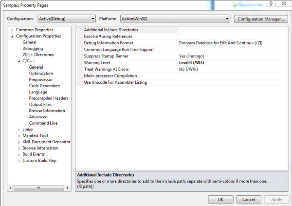

  5. Right-click on the project, and select Properties. The Property Pages dialog appears.
  6. In the property tree on the left of the Property Pages dialog, choose Configuration Properties C/C++ General.

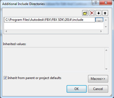

  7. In the properties sheet on the right of the dialog, select <Edit> in the Additional Include Directories drop-down box. The Additional Include Directories dialog appears.
  8. In the list box on the top of the Additional Include Directories dialog, click the top blank line until you see a control to browse for directories.
  9. Use this control to add the full path for the <yourFBXSDKpath>\include directory and click OK.

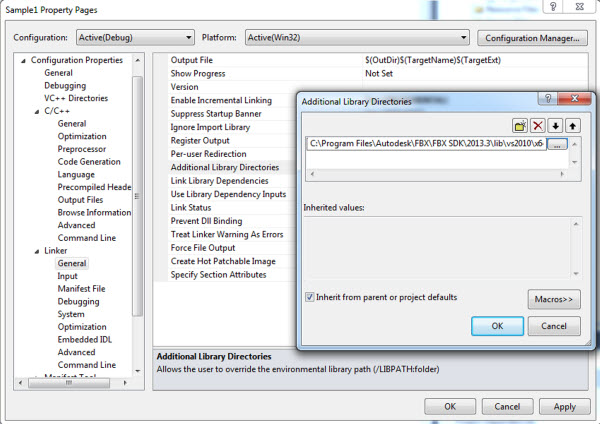

  12. In the Property Pages dialog box, choose Linker General.
  13. In the Additional Library Dependencies drop-down box, select <Edit>. The Additional Library Directories dialog appears.
  14. Enter the full path for the <yourFBXSDKpath>\lib folder of the FBX SDK distribution.
