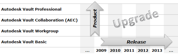

This upgrade process applies to all Autodesk Vault product editions. Details are provided for releases 2009 and higher, however the general process can be applied to all releases.
An upgrade may mean a newer release, a higher product edition, or both. When upgrading, upgrade to the highest release first and then upgrade the product edition.
For example, if moving from Vault Workgroup 2014 to Vault Professional 2016, first upgrade the release to Vault Workgroup 2016 and then upgrade the edition to Vault Professional 2016.
The migration process for an Autodesk Vault environment is composed of five stages: validate backup, upgrade SQL, upgrade Vault server, upgrade clients, and create backup. The number of steps within each stage varies depending on the existing Vault implementation.
