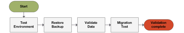

Autodesk recommends that every Vault upgrade start with a validated backup.
The following procedure for testing the upgrade is the preferred method for validating a backup.
The best practice is to perform a test upgrade of the Vault server on a machine that is similar to the production server. A test upgrade provides confidence that the backup is valid and identifies potential pitfalls with no impact on the production environment. Following is an overview of test environment benefits.

If a test environment similar to production is not attainable, a low cost alternative is virtual machines like VMWare or Virtual PC from Microsoft. Virtual machines lack many of the benefits outlined above but are far better than not performing a backup and migration validation.
Use the Vault server application to restore the production backup in the test environment.
If you’re not familiar with Vault Backup or Restore, refer to the Autodesk Data Management Server Help.

Verify the filestore and databases are complete and that the restored environment is operational. Use a client to verify the content and the Vault server application to verify the configuration.
Apply the processes detailed in this paper to the test environment. Using the test environment provides a safe option to experience the migration process and discover unexpected hurdles. Although this process takes time it can, in the long run, save time and stress by avoiding impact to the production environment.
