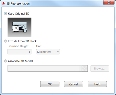

Accessing the 3D Representation Dialog
On the Asset Builder tab, in the Author panel, click 3D Representation to open the 3D Representation dialog box.
Note: The Keep Original 3D option only appears if you previously associated a 3D model to the asset and are in edit mode. You can keep the original association or create a new one by selecting the Associate 3D Model option.
Extruding from a 2D Block
With this method, you enter an extrusion value in the Extrusion Height text box and choose the desired system of units from the Unit drop-down menu. Keep in mind that the extrusion value you enter applies to the entire block.
Note: Objects are extruded based on their bounding block and not their contour. To switch extrusion generation from bounding box to bounding edge, you need to change the UseBlockGeometryFor2dPublish registry key value from 0 to 1. The key is located in the following registry path: HKEY_LOCAL_MACHINE\SOFTWARE\Autodesk\Factory Design Suite\R20. Please use extreme caution when editing the registry key.

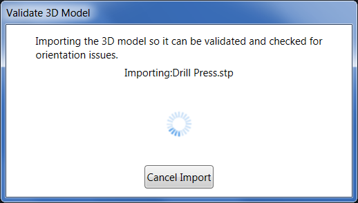

  1. On the Asset Builder tab, in the Define Orientation panel, click Validate 3D Model .
  2. The Validate 3D Model dialog box opens and displays the following message as it imports the 3D model into your layout.
