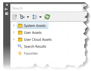

The Asset Browser provides access to System Assets, User Assets, Cloud-based Assets, and asset search results.
Access: Factory tab > Tools panel, click Palettes and then click Asset Browser .
The Asset Browser is made up of the following:
Search | Enter the name of the asset you are searching for. As you enter characters a list of matching solutions is provided. The more characters you enter, the more refined the list becomes. |
Click to begin the search using the search phrase you entered. |
Move up a folder level. |
There are two browser view styles - Tree and Thumbnail. Click the down arrow on the Thumbnail/Tree Views drop-down menu to select your preferred view method. |
Click to display a drop-down menu that provides options to sort assets by asset type, name, or date modified. You can choose to sort assets in either ascending (the default) or descending order. |
Turn the browser tooltips on and off. |
Refresh the browser contents. |
