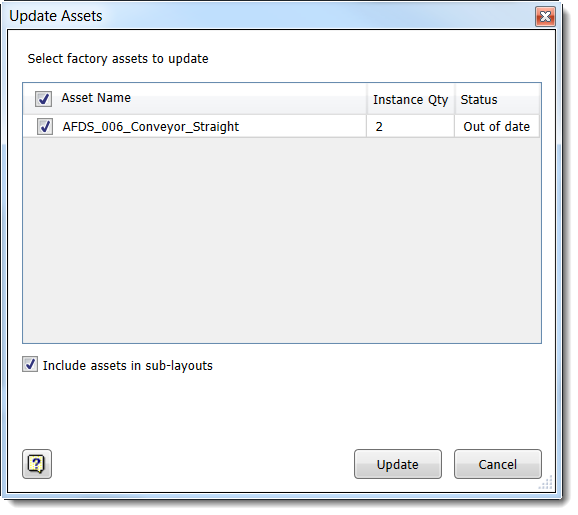

  3. Click Update Assets in the Factory ribbon to display a list of out-of-date assets.
  4. Click the checkbox next to the placed assets to update. Hovering the mouse anywhere in a row highlights the corresponding assets in the layout to help you easily identify what will change.
  5. Click the Include assets in sub-layouts checkbox to also update assets that are placed in subassemblies.
  6. Click Update. The status changes to Successful when asset updates are complete. If an update fails, hover your mouse over the status to see the reason.
