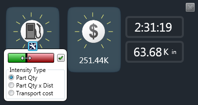

You can adjust the indicator intensity type as well as the information reported on by the indicator.
Access the Indicator settings by clicking
in the Transportation Cost indicator.
Drag the black separator bar between the red and green fields to modify the sensitivity. Specify the Intensity Type.
