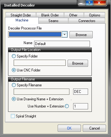

Click File Setup
Installed Decoiler.
A blank Installed Decoiler dialog displays, unless a previous decoiler has been installed.

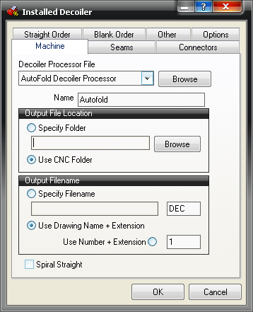

The following dialog displays:
The generic64.dpl file produces a generic text file output that lists the straight items that need to be cut.
Generic decoiler, and most other decoilers, do not output the coil number, so the Coil tab is ignored.
