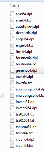

CAMduct has the ability to control certain types of decoiler machines. A variety of preconfigured DPL files (dynamic linked libraries) are included which allow you to control specific decoiler machines. By default, these .DPL files are installed to the C:\Program Files\Autodesk\Fabrication <version>\CAMduct\DPLs folder.
In addition to the .dpl file, an optional .txt file can also be included which allows you to set up custom option text for the decoiler.
