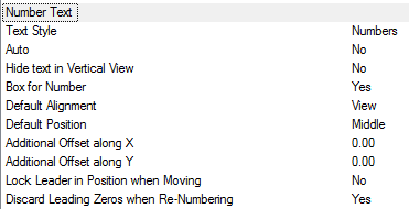

To specify the Number Text options in the database:
  1. Click Edit Main Database Takeoff tab CAD Settings Annotation tab.
  2. Scroll down to the Number Text options.
  3. The Style box is used to specify the AutoCAD Text Style to be used. If the Text Style Numbers is not present, then Standard is used by default.
    • Text Style: Text properties taken from Style named here, if the style dose not exist "Standard" is used. Height, width, font etc are defaulted from style. If only displaying in Paper space, height should be size required for plotting.
    • Auto: Automatically applies the Numbers label to each item drawn.
    • Box for Number: Draws a oblong box around the tag if set to "Yes". You can override the graphics with ITM-NUM, ITM-NUM1, ITM-NUM2, ITM-NUM3 etc. For more information about block names, see Item Number Custom Blocks.
    • Default Alignment: Sets the alignment to View, Length, Connector.
    • Default Position: Sets the default position to Below, Middle, Above, relative to the center node.
    • Additional Offset along X: Adjusts the Number Label Distance in the (X) axis, relative to the current Default position set.
    • Additional Offset along Y: Adjusts the Number Label Distance in the (Y) axis, relative to the current Default position set.
    • Lock Leader in Position when Moving: When spooling and moving Locks the leader arrow onto the Default Node Position.
For more information, see CAD Settings, and scroll down to the Dimension Text options.
