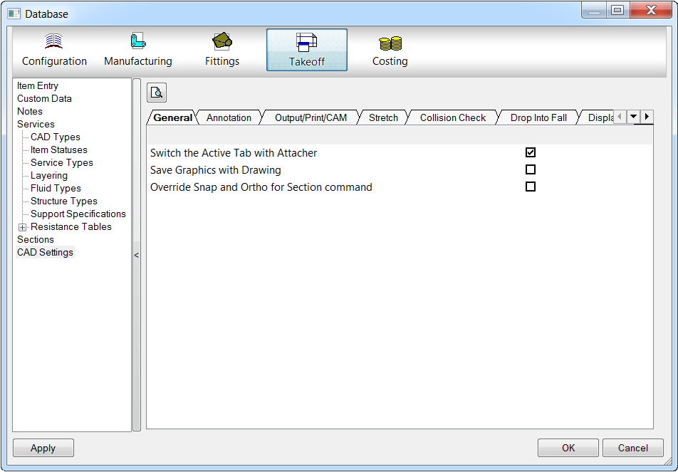

The CAD Settings section of the Database dialog controls various aspects of both the manufacture parameters and the drawing parameters of CADmep Items. These are some of the primary settings used to manage the various aspects of how CADmep controls the drawing of Items.
To access the CAD Settings:
Takeoff
CAD Settings.
The CAD Settings are organized into the following tabs:
Switch the Active Tab with Attacher: This option allows users to configure the functionality for the attacher to change between numerous tabs within a service template when various items are selected with the model.
Override Snap and Ortho for Section Command:
