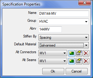

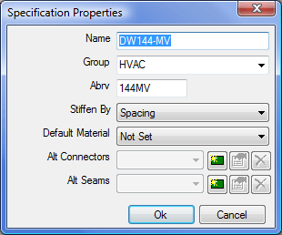

The Specification Properties can be accessed by clicking the Properties icon on the Database Fittings Specifications dialog.
The Specification Properties are described below.
Name: The descriptive name given to identify the specification.
Group: Specifications can be grouped together into separate Groups, to create a new Group type the name in this box. Specifications can then be moved to other Groups by selecting the group from the drop-down box.
Abrv: An abbreviated name used in identifying the specification and on Reports.
Stiffen By: This allows the specification to set the number of Stiffeners used on an item to be determined by Spacing or by an Input Value.
Default Material: The material picked up by default when using this specification in Takeoff.
Alt Connectors: The Alt Connector allows the user to allocate a different set of Connector Information to an item file where you still want the item to follow the rest of the Specification Parameters.
Alt Seams: The Alt Seams allows the user to allocate a different set of Seam information to an item where you still want the item to follow the rest of the Specification Parameters

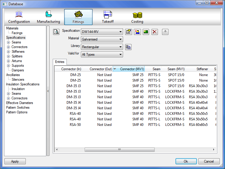

Selecting the New icon in Alt Connectors or Seams will let the user enter a name for the Alternative Field. This will then be displayed in the Specification Table as an Alternative Connector and/or Seam.
In the example above, an Alt Connector and Seam were created called MV1. This then creates the extra columns in the specification Break table.
The item file has to be edited and the Alternative Connector and/or Seam name is entered into the Alt column.
This applies the normal specification entry to the item as well as the Alternative Entry.

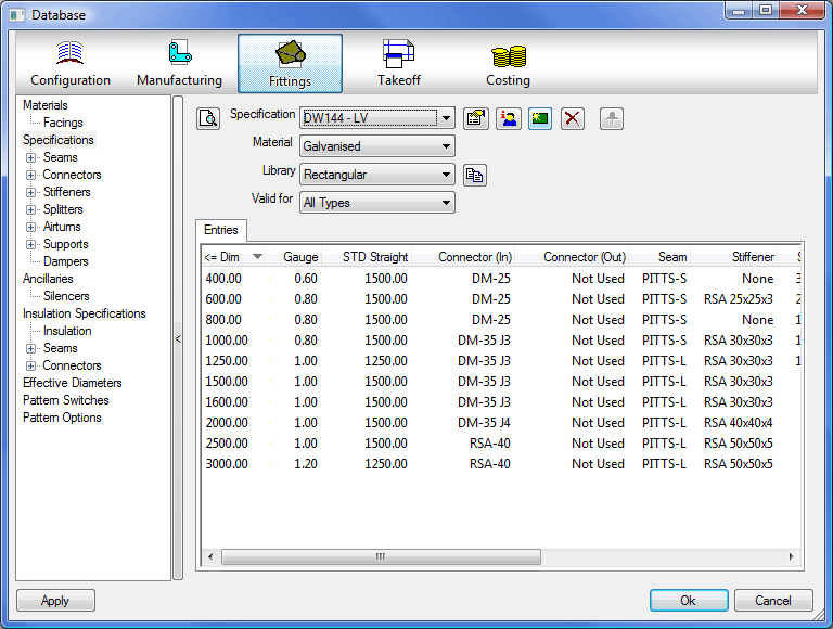

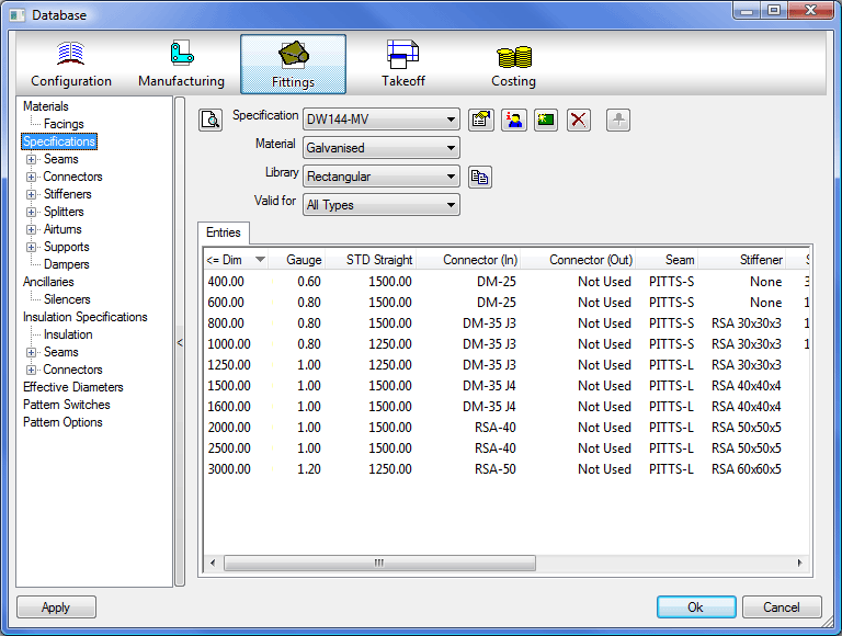

Modifying Specifications
To modify a specification:

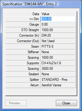

  1. Double click an entry to edit the details.
  2. To create a new entry in the specification, Right-click on the table and click New.
<= Dim : The figure input here will specify that a fitting with a Longest Side value of up to and including that figure will use the factors set here.
Gauge: This specifies what gauge the material will be.
STD Straight: Specifies the standard straight length
Connector (In): Specifies the type of connector used.
Connector (Out): Specifies the type of connector used.
Seam: Specifies the type of seam applied to the fitting.
Stiffener: Specifies the type of stiffener applied to the fitting.
Spacing: Specifies the break points for the placing of the stiffeners.
Supports: Specifies the type of supports for this fitting.
Spacing: Specifies the break points for the placing of the supports.
Sealant (Rectangular Patterns Only): Specifies the type of sealant applied.
Splitter (Rectangular Patterns Only): Specifies the type of splitter applied to the item.
Airturn (Rectangular Patterns Only): Specifies the type of airturn applied to the item.
Collar (Round, Flat Oval, and Standard Only) : Specifies the collar type applied to the item.
Damper (Round, Flat Oval, and Standard Only): Specifies the damper type applied to the item.
Pipe OD: Used in CADmep. Pipe outside diameter.

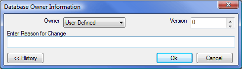

Displaying Owner Information
Click the Owner Information icon to display details on who created the specification and any revision changes that may have been made.

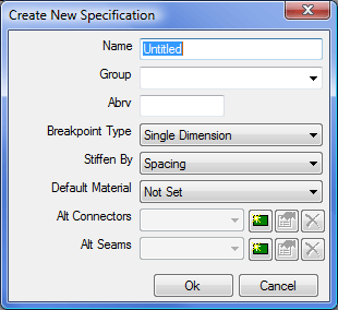

Creating a New Specification
To create a new specification:

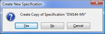

  1. Click the New icon.
  2. A dialog displays asking if you want to create a copy of an Existing Specification, this can speed up the entry of information if the Breakpoints are similar to the currently open specification.
  3. If Yes is selected then the software will create a copy of the specification for the user to edit, if No is selected the Create New Specification dialog displays.
Name: Gives the specification a descriptive name.
Group: This option enables you to create groups and add specifications to existing groups.
Abrv: Here you can give the specification an abbreviated title for use in Reports
Breakpoint Type: There are 4 options to specify the Breakpoint type.
The type of breakpoint used will determine what criteria the specification will look for before applying the breakpoints.
Single Dimension
This specification will look for the longest side of the duct to determine what values to apply to the pattern. The figures in the less than or equal to Dimension field will create the breakpoints.
In the example above, a Single Dimension specification with an item of duct where the longest side dimension that is less than or equal to( <= ) 400mm will apply 0.60 Gauge Galvanised, a DM-25 Connector, PITTS-S Seam, and No Stiffener to the duct. Whereas a duct with its longest side less than or equal to 600mm, but greater than 400mm, will be applied 0.80 Gauge Galvanised, DM-25 Connectors and a PITTS-S Seam and a DM-25 Stiffener.

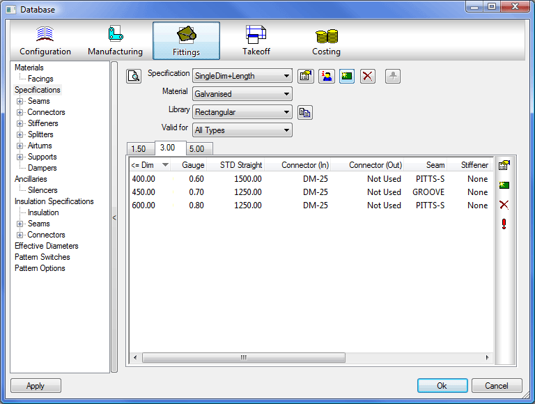

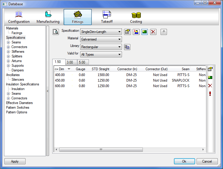

Single Dimension Plus Length
This specification is similar in some respects to the LS/SS specification, but this one looks for the longest dimension in the Width and Height field and looks at the length of the duct to create further breakpoints. The length breakpoints are input by creating new tables in tabs.
In the example above, a duct with a long side of 450mm and a length of 1.5m or less is allocates 0.60 gauge galvanised, DM-25 connectors and a SNAPLOCK seam. Whereas in the table below the same duct but with a length of 3m will allocate it 0.70 gauge galvanised, DM-25 connectors, and a GROOVE seam.
