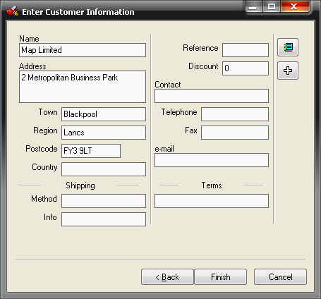

  1. Create a new job, including the customer's name and address.
    To do this:

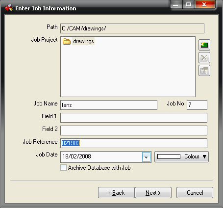

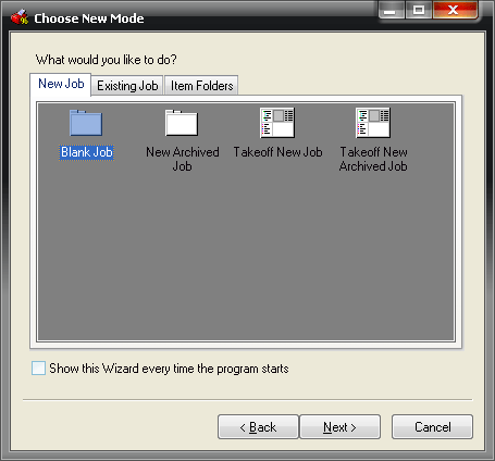

    1. Click File New Job Blank Job, and click Next.
    2. Enter a Job Name and Job Reference as shown below, and click Next.
    3. The Enter Customer Information dialog displays.
      It is now possible to enter the customer details, as required.
      Note: In order for whole address to be displayed on the label, the full address (town, region, postcode & country) should be entered in the address field, as shown in the example below. The Label Address field on the label is limited in the number of characters it can display, and only obtains data from the Address field.
    4. Click Finish when all of the relevant information has been entered.

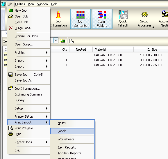

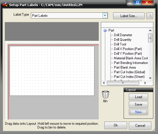

    1. Click File Print Layout Labels.
    2. From the drop-down menu in the Label Type field, select Part Labels.

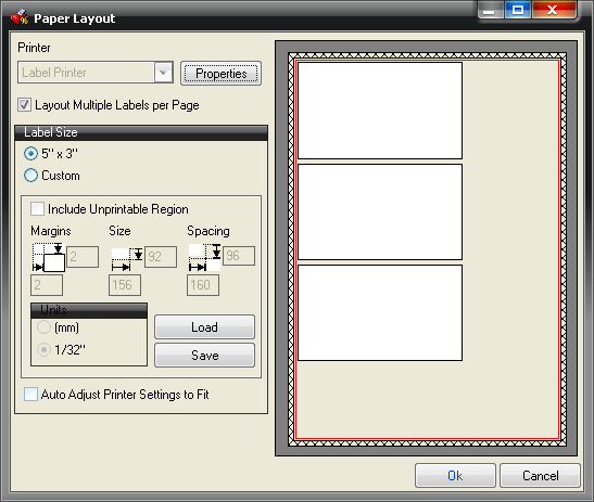

    3. Click on the Label Size button to view and define the layout of the labels.
    4. Set the Label size, and click OK to save any changes, and return to the Setup Labels dialog.
    5. To create a new label layout, click the New button.
      The following warning dialog displays.
    6. Click Yes.

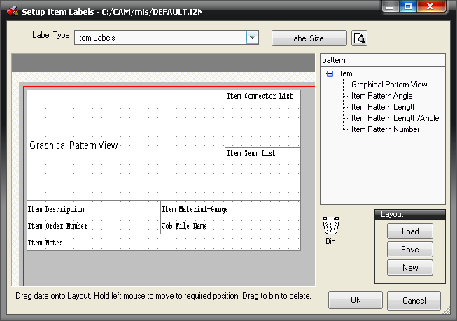

    7. A new, blank label displays.
      The white grid pane on the left is the label. The list in the right pane contains field options that you drag onto the grid once you have defined the layout.

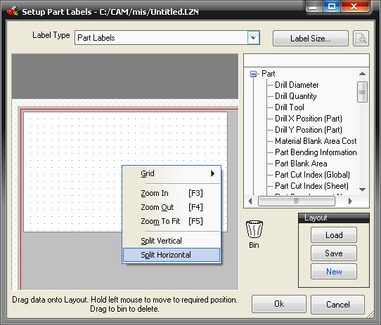

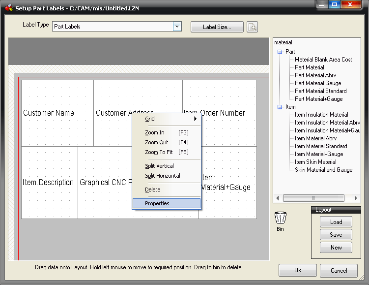

    8. To define the layout of the label, move the cursor over the grid and right-click the mouse button.
    9. On the menu that appears, click Split Horizontal, then right-click the mouse button again, but this time click Split Vertical.
    10. Continue with this method, adding more splits, until it looks like the image below.
      Note: If a mistake is made, the lines can be deleted. Right-click in the field box and select Delete, but note that the field might not be able to be deleted as the line, if it is part of another field. For example, in the example below, the bottom horizontal line cannot be deleted without first deleting the bottom two vertical ones.

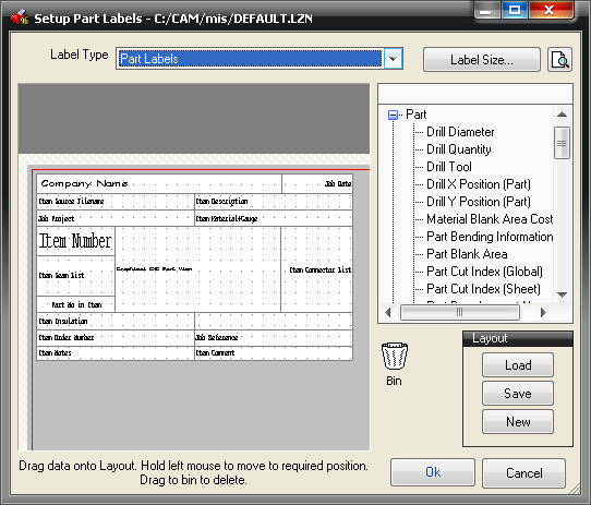

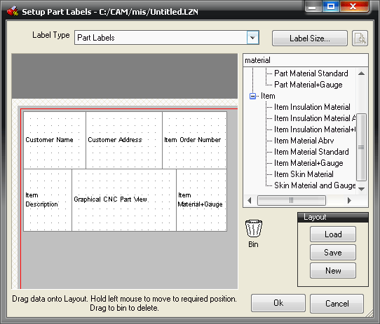

    11. Once the layout has been set up as above, it is now possible to add print objects to each of the cells. This can be done by dragging the required information in required area.
    12. Configure the label to contain the same information as the one below.

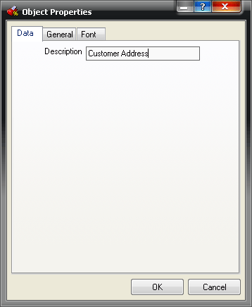

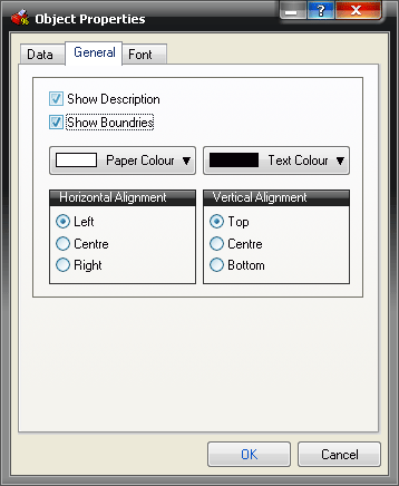

    13. It is now possible to set the properties of each of the print objects that have been added. Right-click on any of the print objects and select Properties.
    14. This option allows different options to be set. Right-click on the Customer Address print object, and select Properties. Set the General and Data tabs as shown below.
    15. Click OK to save changes and return to the Setup Labels dialog.
    16. The Item Labels can be customized in the same was as the Part Labels were.

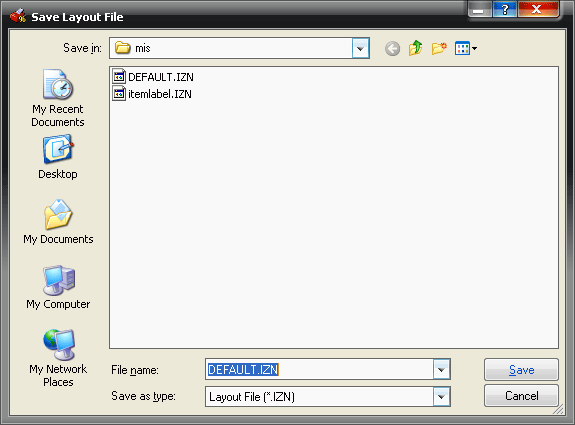

    17. To save the customised files, click Save, and select the name of the file you want to save as in the Save Layout File dialog.

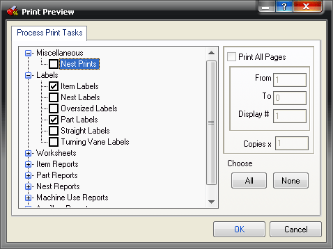

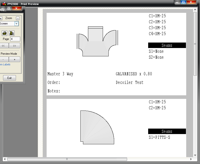

  5. Assuming that the Label printer has been set up, it is now possible to print preview or actually print the required labels. To do this:
    1. Click File Print Preview, and select the Part Labels and Item Labels.
      The labels are displayed in the Print Preview mode.
    2. Navigate through the reports by clicking the + sign under the Preview Mode heading on the Preview dialog.
