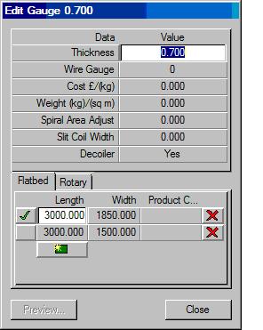

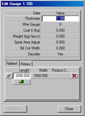

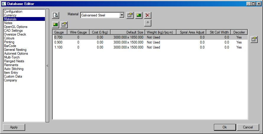

Set a material with the coil thicknesses required for use with the Forstner Decoiler.
For each material thickness create the width required for use with the Forstner Decoiler.

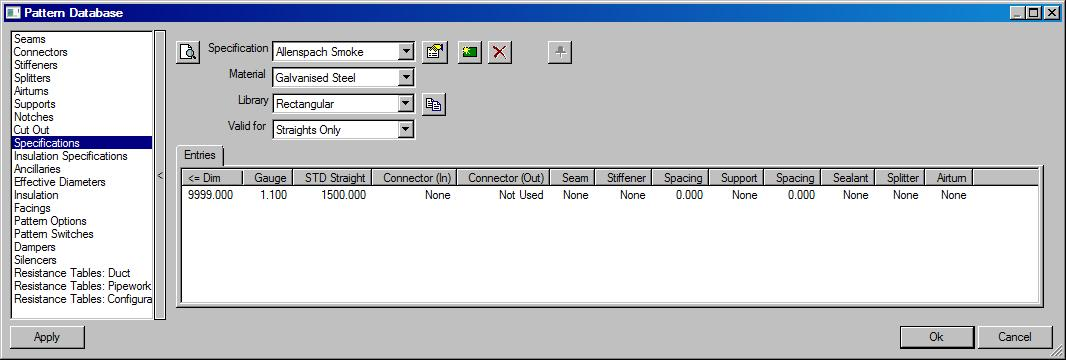

Pattern Database - Specifications
Set up Specifications that will create Straight Items suitable for use with the Decoiler.

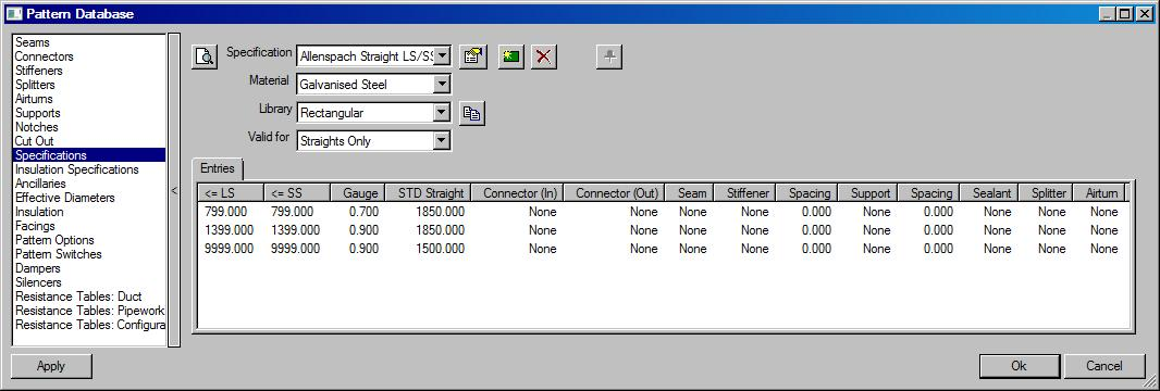

Pattern Database - Pattern Options - Straights
Set up the Straight options like this to allow the Decoiler to use the two coils widths of 1500 and 1850 for standard straights, these will be made on Line 1. Straights that do match the two standard lengths will be made on Line 2.

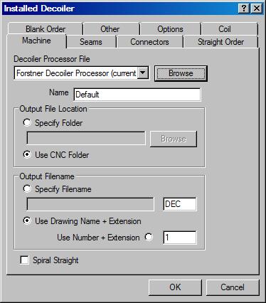

Installed Decoiler
Main Tab
Setup a Decoiler that uses decoiler post processor FORSTERNDPL.DPL. Click on the Browse button to locate the decoiler post processor file.

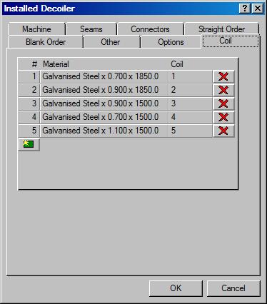

Coil Tab
This decoiler post processor supports the new Coil allocation tab. Use the Coil tab to allocate coil numbers to the materials that will be used with the decoiler.
The Coil value will be output in the "Tisch" field in the ASCII file.

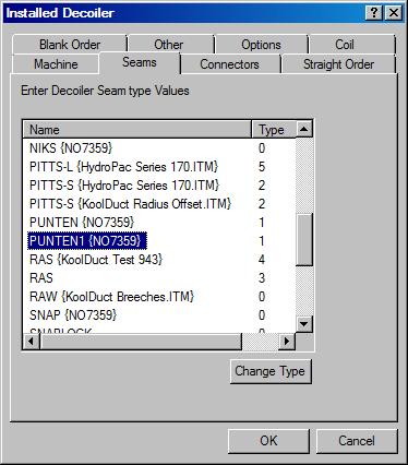

Seams Tab
Each seam can be give a Type value in the range 0.8.
The Type value will be output in the "FaType" field in the ASCCI file. If the Type value is 0 the Male and Female Seam Allowances will be output in the "FaZu Anf" and "FaZu Ende" fields.

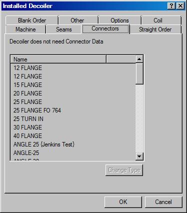

Connector Tab
This tab has no effect with the Forstner post processor.

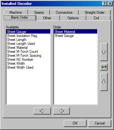

Blank Order Tab
If the decoiler is being used to cut sheet blanks for use on a cutting machine this tab controls the order in which the sheet blanks will be output in the ASCII file.

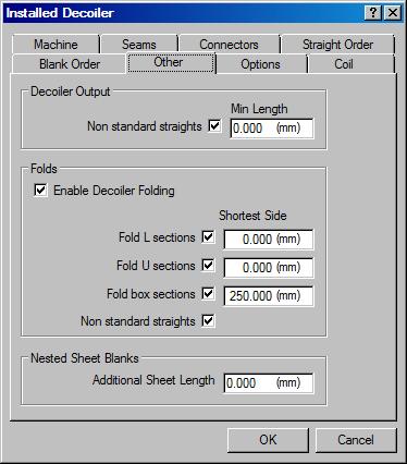

Other Tab
This is mostly used to control the folding options for the various duct section types. For the Forstner decoiler the box sections must be at least 250mm to allow the former to create the duct section.

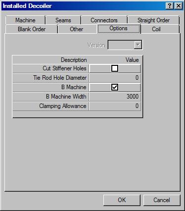

Options Tab
This tab is used to control options which are machine specific. For the Forstner decoiler the two most import options are the B Machine option, which enables the use of the second line, and the B Machine Width option which should be set to the width of the 2 second line. The second line is normally used for making no standard length straights.
