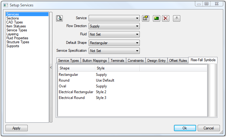

Override Option for Rise - Fall Symbols For Each Individual Service
To override Rise - Fall symbols for an individual service:
  1. Click Edit Service Database.
    The CADmep Setup Services dialog displays.
  2. Click the Rise-Fall Symbols tab.
  3. To customise the Service with a specific Rise-Fall symbol, the Style options must be selected and changed to suit a specific symbol. Refer to the previous sections illustrating all the symbol styles available for Duct Ventilation, Mechanical Pipe, and & Electrical. For more information, see the description of Display tab settings in CAD Settings.
    The options available are:
    • Rectangular: Use Default, None, Style 1, Style 2, Supply, Extract, Exhaust
    • Round: Use Default, None, Style 1, Style 2, Supply, Extract, Exhaust
    • Oval: None, Style 1,Supply, Extract, Exhaust
    • Electrical Rectangular: None, Style 1, Style 2, Style 3
    • Electrical Round: None, Style 1, Style 2, Style 3
The Use Default option uses the settings enabled within the Main Database Rise & Fall Symbol settings.
The None option will not apply a Rise & Fall Symbol to that particular Shape / Service.

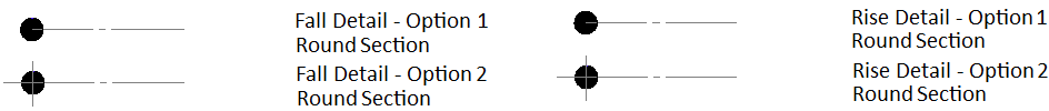

Duct Ventilation
The available Styles are as follows:

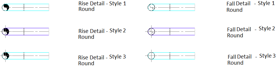

Mechanical Pipe

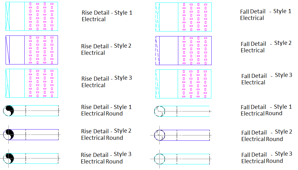

Electrical
The available Styles are as follows :

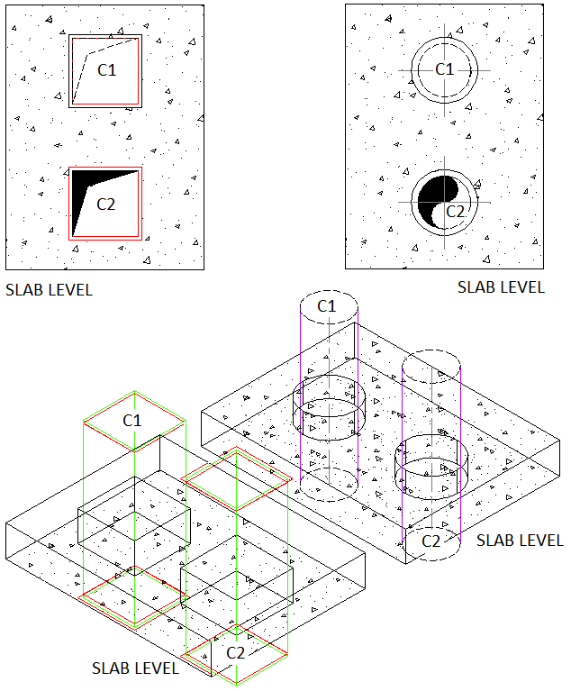

Overriding and Enforcing Rise-Fall Symbols on Objects in a Model
The following example illustrates a duct ventilation rectangular and spiral straight item passing through a structural slab level.
Note: Any object with CADmep Service ranges can have Rise & Fall Symbols applied.
  1. Select the CADmep straight for the object to become active.
  2. Right click Rise-Fall Symbols > C1 End or C2 End.
  3. To enable either End Connector (C1) or End Connector (C2), select C1 End or C2 End as required. The above example shows a duct ventilation rectangular and spiral straight item passing through a structural slab level end connector locations of C1 and C2.
  4. To turn off the Rise and Fall Symbol, select Off.
