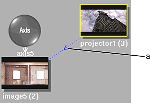

  3. To make the projection selective, access the schematic by using the ~ key or by selecting Schematic from the View box.
    In the schematic, the projector is displayed much like an image. By default, it projects an image across the entire scene.
  4. Select Light Link from the Tools box to create lighting connections.
  5. Do one of the following:
    • To project only a selected surface, drag a connection from the Projector node to one or several nodes in your scene. A selective projection connection is represented by a blue dotted line.
      Once a selective connection is created, the projector only affects the object to which it is connected.
    (a) Inclusive projection connection  
    • To exclude a surface, hold the Alt key as you drag a connection from the Projector node to a surface node. The exclusive connection is represented by a red dotted line.
