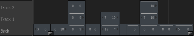

- Verify that the shot has a "layered cake" structure.
This structure is the best layout when publishing a shot: Flame uses a bottom-most left-most segment part of the shot to create the shot's timing structure.
- Identify segments that are part of the shot by assigning them an identical shot name. For
Flame Assist, a shot is a group of segments that have the same Shot Name.
You can edit the shot name from the Conform view, or with the Rename Shot option from either the Timeline gear menu or contextual menu.
- Repeat for each shot on your timeline. Make sure to assign each shot a unique name.

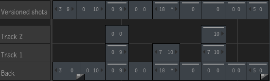

Once the export is completed, you can see, next your original sequence, the published timeline named as your sequence but appended with
_publish.
When you open a shot published sequence, the versioned shot appears on a different Version layer of the sequence. The bottom Version contains the original sequence.
The versioned shot actually contains all of the media of the shot and effects, keeping the timing from the original sequence.

- Open the published sequence.
The original sequence is displayed on the bottom Version of the timeline. A new Version contains the track with the published shots and referenced media.
