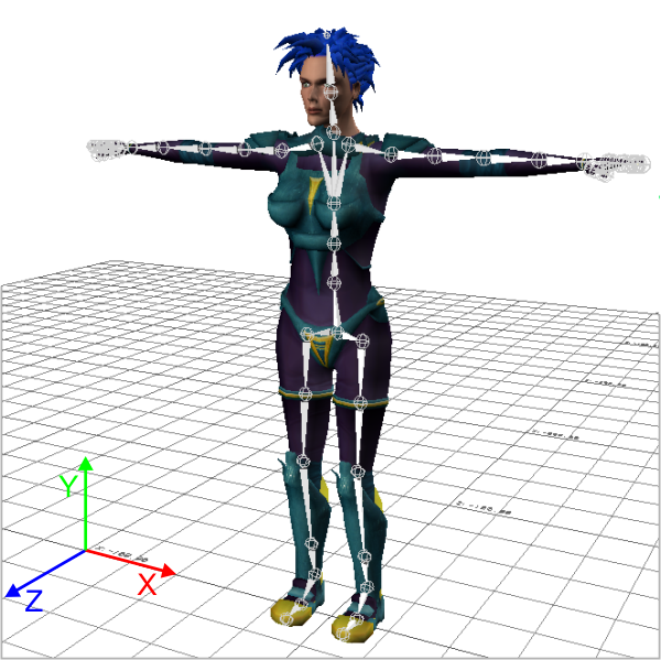

In order for the HumanIK solvers to control a character, that character must be initialized in a basic T-stance that provides the HumanIK bio-mechanical model with crucial information about the geometry and proportions of your character’s skeleton.
Your character’s T-stance must match the description and example given below as closely as possible in order for the HumanIK inverse kinematics and retargeting solvers to produce accurate results for your character. Without a properly configured T-stance, the HumanIK solvers will base all of their operations on faulty data, and will likely produce skewed, awkward or unexpected poses.
The T-stance has the following requirements:
A typical T-stance is shown in the following image:
