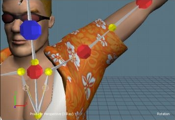

HIKRealisticShoulder
Determines the percentage of the rotation applied to the shoulders (the LeftShoulderNodeId and RightShoulderNodeId Nodes) that is extracted from the shoulder and applied instead to the collar bones (the LeftCollarNodeId and RightCollarNodeId Nodes), to simulate the behavior of human shoulders when the arms are raised.
For example, in the image on the left, the character raises its left arm without the HIKRealisticShoulder property activated. The resulting pose creates an unlikely configuration of the shoulder.
In this image, the HIKRealisticShoulder property is activated, and its value is set to 1.0. When the arm rotates, 100% of the rotation is transferred back to the collar bone, causing the model’s shoulder to move upwards.
