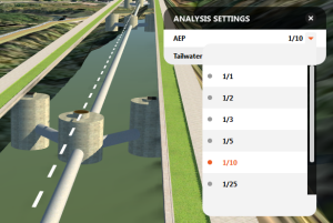

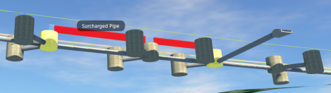

Inspect visually and check data for the hydraulic and energy grade-lines for a selected pipe run. Identify surcharged pipes and flooded manholes. Adjust AEP setting to model performance under different storm level conditions.

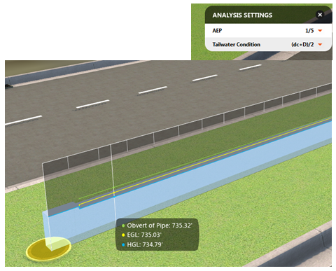

Inspect Performance returns:

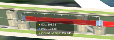

Blue bar: the depth of water in the pipe (not the flow); that is, the hydraulic gradeline.
Green line: the obvert, or inside, of the pipe.
Yellow line: the energy gradeline.
