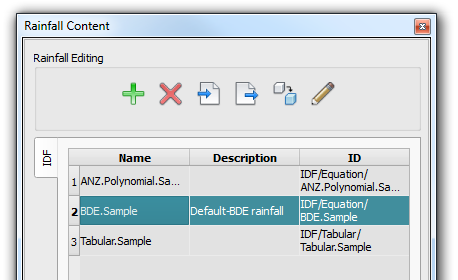

  1. Click to open Rainfall Content.
    It first opens in a tab along with the Model Explorer. You can detach Rainfall Content to display as a standalone panel:
    You can use the standard interface icon-tools to add, delete, import or export a rainfall file, create a copy of the currently selected rainfall content, or edit it in the IDF Rainfall window.

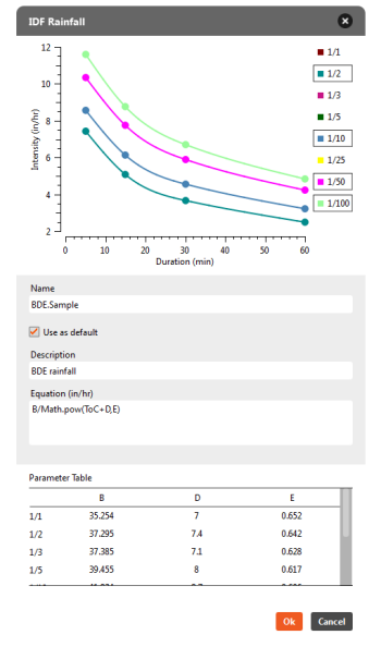

  2. Double-Click (or select and click edit) a sample IDF formula to open it in the IDF Rainfall window.
    • Graph shows the IDF curve for each AEP condition you select, using the formula shown in Equation.
    • You can set the current selection as the default. You can edit the current Rainfall Content's Name, Description or Equation.
    • Parameter Table shows the values used for each condition represented in the current formula.
  3. After editing the fields you want to change, click OK.
