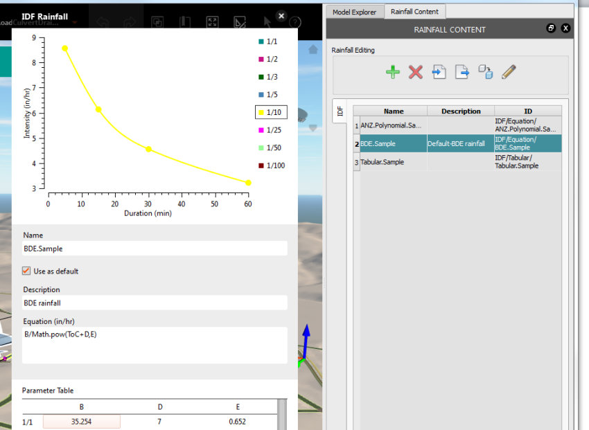

Rainfall Content and IDF Rainfall Panels
The rainfall content manager opens initially as a tab, along with the Model Explorer. You can move it to display the panel in its own window.
You can also double-click to open a sample in the IDF Rainfall window. The panel graphs the IDF rainfall curve for each of the AEP conditions you select. You can rename a sample or name a new one, describe it and state its equation. Note that you can set current formula as the default.
The panel also shows these data in tabular form. The fields change to reflect the sample formula you are working with. You can work with the tabular data to specify the most accurate curve for your design.
